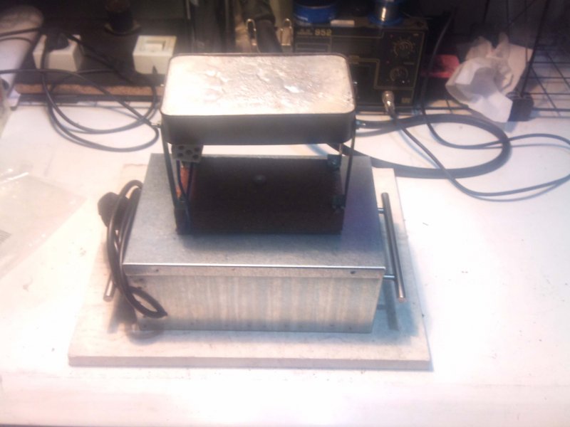

Then chop off the bottom of her that will be used as when the melt tin. Enough is 1-2cm height.
The next step is to make the heater.
heater you need waiting wires. If you do not take some old heater from a heater, an old fan off ... and roll 1m wire. Measure the resistance of her as you will need this information later.
before the budget should opt for another 2 parameters. Power peaks and voltage.
power my heater is 100W, I recommend that Neid below that because you will be waiting a very long time to melt the tin after switching.
adjust voltage source that you have. I have an adapter with regulation from 0-35V and I opted for a voltage of 30V.
calculation looks like this: U = 30 V P = 100 W rt = 28.6 ohms / m (resistance waiting wires per meter) Rt =? (Resistance heaters) Rt = U ^ 2 / P = 30 ^ 2/100 = 900/100 = 9 ohms heater wire length L = Rt / rt = 9 / 0.3 = 28.6 m If you have a count neda regulated power source. Simply take a piece of wire and waiting for pick up the heater voltage while they have brought to red heat. This method can be used to check the budget. The picture below is my heater. Wound on Borer 3m and stretched down to size.
Finished heater must somehow isolate the metal masses. I used ceramic beads taken from one heater oven.If you do not have them you can buy in the stores where they sell spare parts for kitchen appliances.
Earlier in the prepared tin must be in some way attached to the frame, I was punched in the middle and used a spacer to mount the PCB into the box. It can be a plain screw with two nuts.
Heater placed in the slot cans
The heater should be pressed with a tin and tin must be attached to a frame. I opted for the protective foil 12cm fan removed from the old PC power supply.
Put-heater and attached to the grid
Assembled legs and ceramic chandelier clamps holding the heater running.
Connected and commissioned. Pieces of tin melt.
In the next few pictures you will see desoldering process step by step.

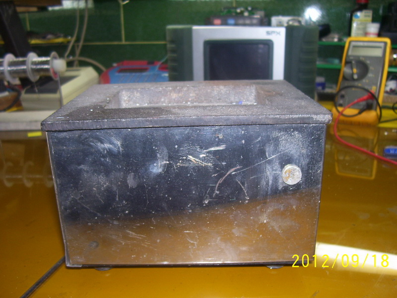

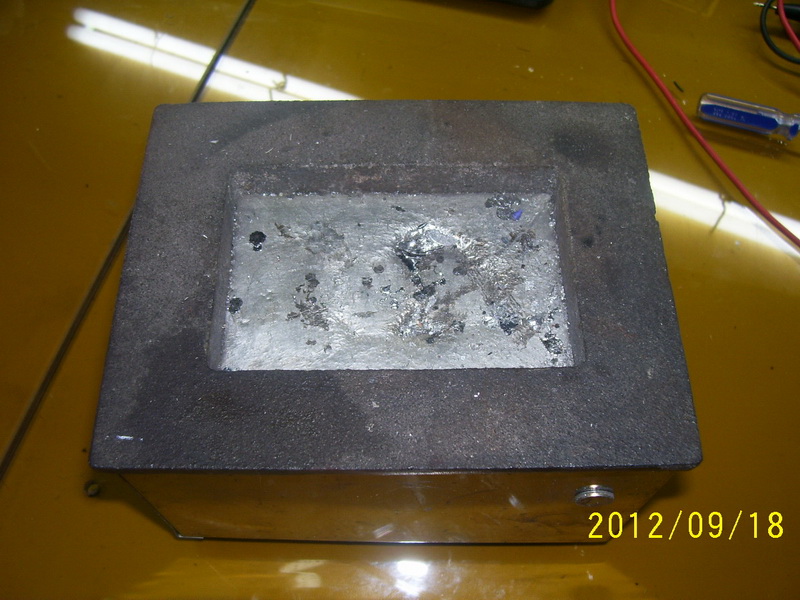

farah676
2007-08-22
4,688
62,033
با عرض سلام
جناب شمس عزیز دو اشکال در این حمام وجود دارد ، اول اینکه قطع به بدنه خواهد چسبید و مورد دوم اینکه بسرعت سرد میشود ـ حوضچه از چدن باید باشد)
من یک نمونه کوچک را به مبلغ 40 تومان خریده ام و کار کرد بسیار خوبی دارد
