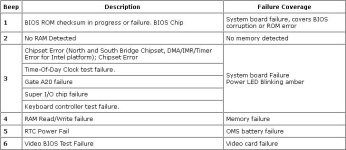

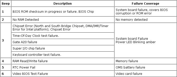

تو ستاپ گاید این مدل لب‌تاپ نوشته ۳ بوق = Possible system board failure — Chipset error

System Beep Codes
Dell™ XPS One™ Service Manual
The <%= strMarketingName %> can emit a series of beeps during start-up if the display cannot show errors or problems. These series of beeps, called beep codes, identify various problems.
3 means 3-3-3-3… That is 3 beeps and 3 beeps and …: Endless looping until you press the power button to shut down the system.
The delay between each beep is 300ms, The delay between each set of beeps is 3 sec, The beep sound last 300ms.
After each beep and each set of beeps, the BIOS should detect if you press the power button. If you do, BIOS will jump out from looping and execute the normal shutdown process and power system
See this Link :
