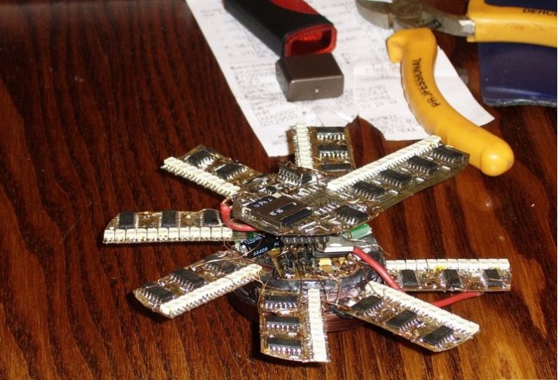

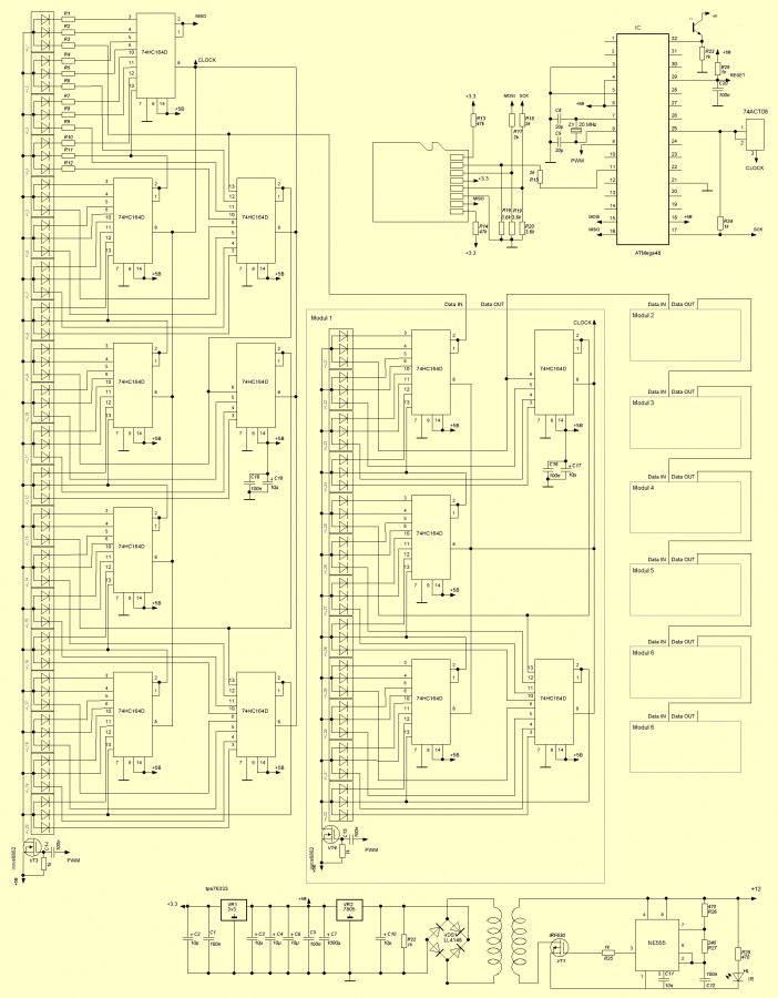

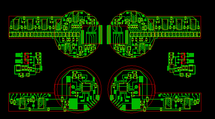

سلام دوستان
در این تایپیک نوشتار یا اشکال گرافیکی با قابلیت ایجاد در هوا قرار داده میشود.
این مدار قابلیت نمایش 3 بعدی و فلش خور بودن دارد. به همراه فیلم . pcb و فایل هگز تقدیم می گردد. تشکر
با توضیحات زبان اصلی
I wanted to create something of such things beautiful and awesome. with conventional animation, decided to create three-dimensional. This idea originated long ago, but knowledge is clearly not enough, because it was necessary to operate a vast array of data. 8-bit AVR-stone seems can not do it, even looked in the direction of the percent CYGNAL. But I was wrong. And the proof - my draft fan with 3D animation. idea is as follows: a strip of 12 LEDs draw a picture in the same plane, taking eight of these strips and placing them at different heights, we obtain eight planes, together creating a 3-dimensional animation . central part of the design is a microcontroller ATMega48, clock frequency - 20MHz. The output produced by the LEDs in series with the help of shift registers 74NS164. All images and animation are stored in the memory card microSD. Pictures MC does not handle, transfer data from the card is directly in the shift registers. Pictures are made ​​with the help of special software. MK only synchronizes the transfer, depending on the position of the LEDs.
[hide]
[/hide]
[hide][/hide]
[/hide]​
[hide]
[/hide]
The whole scheme consists of a main board and 7 more. Located on the main microcontroller ATMega48, 1GB memory card, shift registers, and 20 LEDs RGB. The remaining seven are located further to 12 RGB LEDs, 5 registers and the control transistor. The main board is located at the top, the rest - a step below about 4 mm. The signal from the photocell is supplied to the IC shielded wire.Power Card provides tps76333, matching levels using resistor dividers, current-limiting resistors on the LEDs no food for them, formed a hardware PWM, the capacitor at the gate of the transistor control needed to protect the LED for programming and other force majeure. The power supply system is implemented using an air transformer. The master oscillator assembled on a 555 timer. Power switch - IRF630. Primary and secondary windings contain approximately 90-100 turns of wire with a diameter of 0.35 mm.In a corner of the body drilled by an infrared LED, LED brand - any. All the elements are attached with superglue.
files for fans prepared a special program. Since the I really wanted to put the fan on the contest, but time was running out strongly, the program was a very crude sense, and now it does not spread. The failure occurred, and with LEDs - bought in our city the past, but 4 is not enough. Order in Moscow - not time-bound.
control program is written in CodeVision, post the complete project.
enclose a signet, pictures of the finished device, and video.
PS It was in a hurry to finish the fan until the end of the contest, so many flaws, but I plan to bring it to mind .

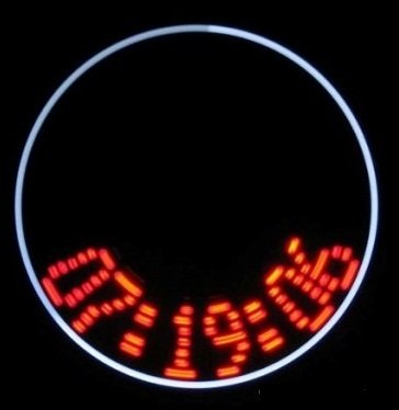

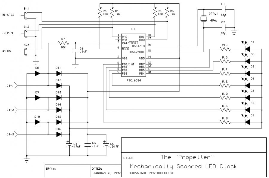

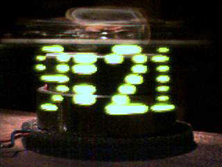

پاسخ : ایجاد اشکال گرافیکی و نوشتار بوسیله ال ای دی در هوا( ساعت)

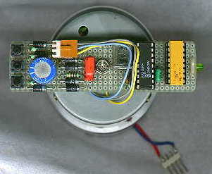

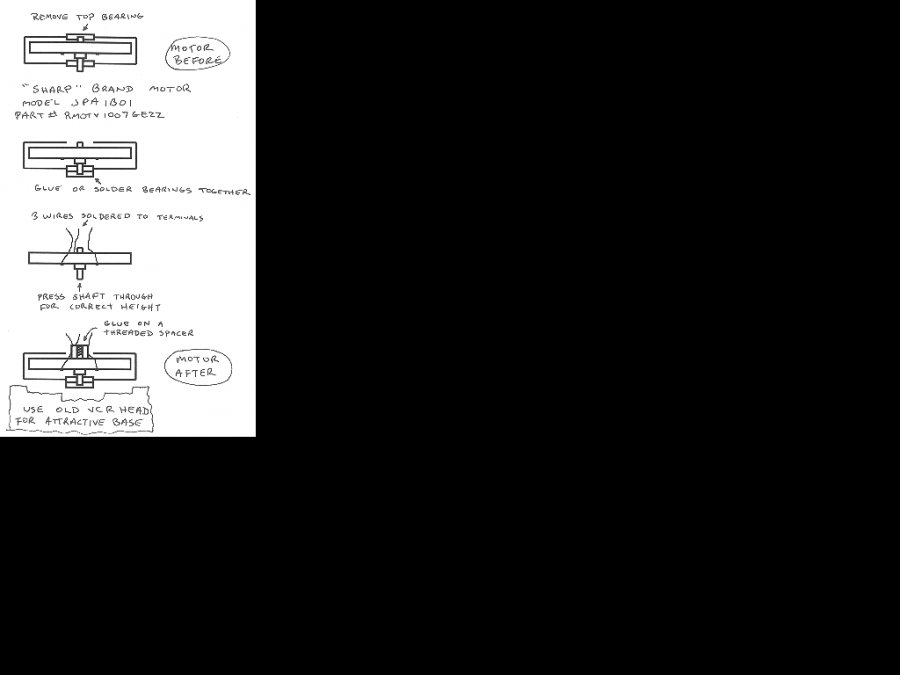

سلام دوستان
این بار ساخت ساعت ونمایش آن در هوا
[SIZE=+2]"Propeller Clock" Mechanically Scanned LED Clock[/SIZE]
Seven light emitting diodes spin, giving the illusion of numbers in the air.
his is the first clock I ever built. I've built a few LED signs, but they get boring because I already know the message.
How this clock works:
A motor spins the "propeller", and a small microprocessor keeps track of time and changes the pattern on seven LEDs with exact timing to simulate a 7 by 30 array of LEDs. It is an illusion, but it works nicely.
If you want to build this clock, you will need a few things, including:
Skill with motors and mechanical things.
Prior electronic experience.
A dead VCR or floppy drive or other source of a suitable motor and miscellaneous parts.
اینهم فایل هگز و اسمبلی
[hide]مشاهده فایل‌پیوست ساعت در فضا.rar[/hide]

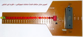

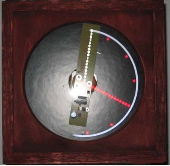

ممنون از شما دوست عزيز . لازم به توضيحه كه ايده اصلي اين طرح مربوط هست به آقاي bob blick كه هر چند به همين صورت جواب ميده . اما البته اشكالاتي هم داره .
مهمترين ايرادش مربوط ميشه به نوع برنامه نويسيش . چون از دستورات تأخير استفاده كرده بنابراين با تعويض موتور ، نمايش اعداد به هم خواهد خورد .
مشكل بعدي مربوط ميشه به نحوه تهيه تغذيه PCB كه باعث ميشه سازنده مدار در انتخاب موتور ، با محدوديت مواجه بشه .
اما در كل چون ايده اوليه بود ، در نوع خودش جالب بوده .
مدل اصلاح شده اي از اين مدارو من ساختم كه تا يه مدت ديگه در وبلاگ خودم قرار ميدم و آدرس وبلاگ رو همون موقع اعلام خواهم كرد تا اگه دوستان مايل بودن به اونجا مراجعه كنند ...
kidamen
2009-10-04
54
311
با سلام دوست عزیز خودت ساختی چون من چند سال پیش از سایت 320ولت چند تا نقشه گرفتم ولی عملی نمیشد
سلام به شما :
بله ... ايده من هم برگرفته از همون طرح bob blick بود . اما من اون طرحو نساختم .
من براي مدار خودم از ميكروي 8051 استفاده كردم . حتي اونو در دو حالت عقربه اي و ديجيتال طراحي كردم كه خوب خيلي هم زحمت داشت . اما جواب داد و عكسشو ميتونيد ببينيد .
ولي بعدا" با ميكروي AVR اصلاحش كردم و مدار تغذيه اونو هم عوض كردم و ميخوام يكسري امكانات ديگه هم بهش اضافه كنم و اينكه گفتم تا چند وقت ديگه ميذارم تو وبلاگم ، به اين خاطره كه هنوز تكميلش نكردم ،
البته قبلتر از اون هم يه دونه با ميكروي زاغارت 89C2051 ساخته بودم كه اتفاقا" ازش فيلم هم داشتم . اما الان نميدونم فيلمش كجاست . اگه پيدا كردم همينجا آپلود ميكنم .

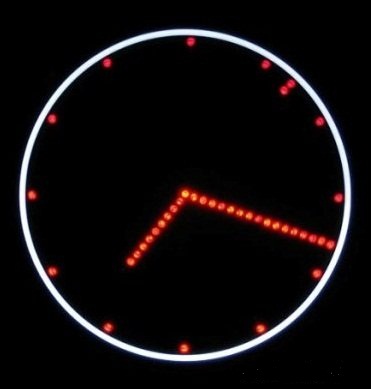

پاسخ :ساعت آنالوگ و دیجیتال قابلیت تنظیم با کنترل از راه دور

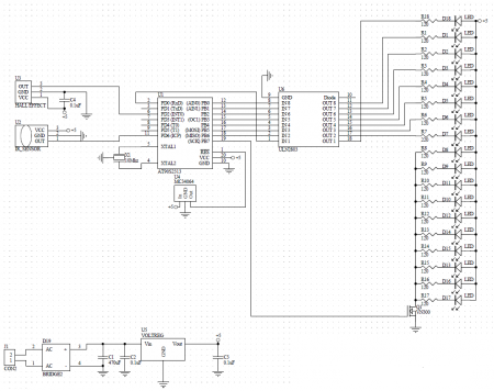

سلام دوستان
تقدیم به شما
Another project on the propeller clock. AT90S2313 microcontroller used it as Attiny2313. Hall sensor U3, a magnet for him should be set at 12.00 hours. IR detector U2. The voltage regulator U5 in 7805.
Features:
Analog Mode
Digital Mode
IR set the clock with the standard remote control SONY
[hide]مشاهده فایل‌پیوست clock.zip[/hide]
