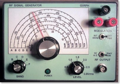

This photo was kindly supplied by Richard Hanes. Richard added an extra frequency band (up to 30MHz) as detailed towards the end of this article.
The unit covers a frequency range of 150KHz to 12MHz over five ranges (shown below). It is therefore suited to the alignment of RF and IF sections of AM (MW and LW) sets, as well as the IF sections of FM (VHF) circuits. It may also be used for RF alignment of SW circuits from 25 to 49 metres.

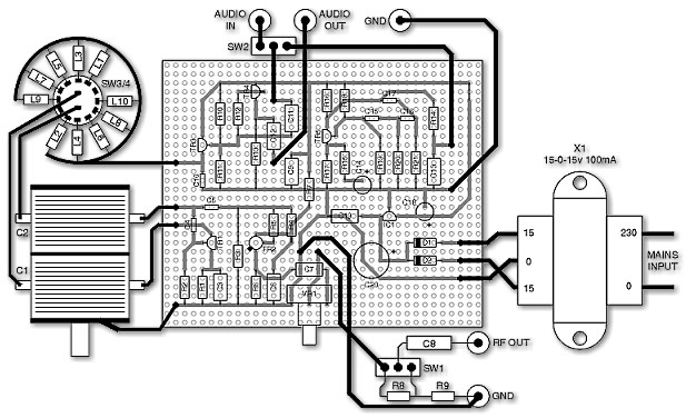

The prototype was constructed on a piece of plain matrix board. Stripboard is not suitable because of the capacitance between adjacent tracks. A PCB could be designed, but this should follow the same general layout as the matrix board.
In the diagram the components and wires on the top face of the board are shown in black, while the underside connections are grey. Much of the circuit board wiring can be carried out using the component leadout wires, with pieces of tinned copper wire added where these are not long enough.
Note that there is an error on the above diagram. TR2 should be shown as a D shaped package the same as the others (with the flat face towards TR1).

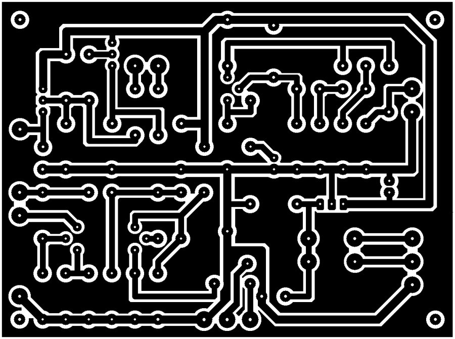

John Shepherd has designed a PCB for this project. The files are available to download from this website, the link is at the bottom of this page. Doug Baird added:
On the PCB, there seems to be a pad missing for the pot that is at the front of the board. I am including a PCB that I did. Sorry about taking the audacity to use the one there, then modify it but I am sending it along as a gif attachment. Use it if you like.
Doug's PCB file is also available below.​
The unit should be built into a suitable metal cabinet to give adequate screening. This should be earthed via the earth wire of three-core mains flex.
C1+C2 is a Jackson Type-O air spaced variable capacitor. This is the most expensive component in the unit, costing around £15. However valve radio enthusiasts should be able to salvage something suitable from a scrap set.
You may wish to arrange a suitable pointer and scale if you intend to calibrate the unit. A suitable ball reduction drive and pointer (also made by Jackson) are available from Maplin and other suppliers. Alternatively, you may be able to use the scale and pointer arrangement from a scrap set.
The inductors are mounted on the rear of the rotary switch as shown. This should be positioned close to the variable capacitor to keep the wire lengths to a minimum. In addition, the circuit board should be positioned to give a minimum wire length to the variable capacitor and switch.
