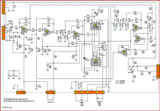

Audio Modular MIXER with 6 and up input Channel
A lot of friends ask me a circuit AUDIO MIXER, for various uses. I will begin with a circuit which you can it manufacture, as you want. This you can place in the MODULES of inputs any circuit you want, depending on the use that you intend the MIXER, the same is also for the number of input channels, that you will manufacture. Below I will give enough circuits with various levels of quality and complexity. All the circuits that propose and are simple also they maintain, a very good level of quality. For those who they are interested they can make few patience. Shortly I will give project, professional level console of mix signals of sound.
In the Fig. 1 exist the main circuit of MIXER-6Ch. It is constituted by 6 input channels. The channels from CH 1-4 are monophonic channels. The circuit that you will select for this place, can be in input connection, BALANCE or UNBALANCE [ Symmetrical or asymmetrical ], have POWER PHANTOM, for Electret microphones, use various types plugs of input. The channels CH 5-6, are intended for stereo use. The number of input channels they can increase itself as long you want, making choice between mono and stereo of circuits. More details for the input circuits I will give separately for each circuit. The output of each channel drive the RV1-6, that potesometer regulation level of sound. With RV7-12 we create conditions of balance between two channels [ panoramic potesometer [ BALANCE ]]. All the signals from the input channels in this point are added by two adders [ IC1a-b ], for each channel Here exist two trimmer TR1-2 that adjust the gain of each IC, adapting the level of signal of output, in the level that we want. They can be suppressed if you do not need such something. The next stage is a EQUALIZER [ Fig. 9 ], three band of regulation. The IC3α-b, constitute the output of MIXER, they are have gain one and they make the essential isolation of previous stages, with the unit that we will drive. For whoever they want they use headphones, it exist a classic circuit drive of headphones, round the IC2a-b, that give output in the JF13. It can also exist also optical clue of audio level, with a STEREO VUMETER. Circuit that you can select between what I give in the category of VU Meters or that other you want. The supply of various circuits becomes from the power supply that connect to JF12b and gives a variety from voltages, that probably will need. .
  • VU Meter collection [1][2][3]
Part List [Fig.1]
R1.....12=4.7KohmsRV1....4=47Kohms Log. [Fader]C19-20=220uF 25VR13.....24=10KohmsRV5-6-13=2X47Kohms Log. [Fader]Q1-3=BD139R25-26=22KohmsRV7....12=10Kohms Lin. pot. Log.Q2-4=BD140R27-30-34-39=100ohmsTR1-2=4.7Kohms trimmerIC1-3=NE5532R28-29-36-37=100KohmsC1....8=10uF 25VIC2=NE5532 - TL072R31-42=10KohmsC9-11=47pF ceramic or mylarJF1....6=XLR Female PlugR32-41=4.7KohmsC10-12=47uF 25VJF7....11= RCA Female PlugR33-40=10KohmsC13-14=100uF 25VJF13=JACK Female PlugR35-38=47ohmsC15-16=2.2uF 16V [C17-22=No use]All the Resistors is 1/4W 1% metal filmC18-21=100pF ceramic or mylar
Modules for mono Input Channels
A simple choice appear in the Fig. 2, in asymmetrical [ unbalance ] connection of input. It uses integrated circuit [ IC1 ], in inverting and possibility of regulation gain of unit, for low levels [ microphone ] up to high [ line ]. With switch S1 we can, if it is necessary we give supply for the operation of Electret, condenset microphones. In the place of IC1 we can use a variety from integrated circuit that give below. The type of integrated circuit that we will use, depend from the number of input channels, that we will manufacture, for this reason I do not give also concrete type. My own choice is: IC1=NE5534 - NE5532 - LM833- TL072- TL074.
Electronic Balance Mic-Line input Module
In the Fig. 3, appears one stage with much better characteristics, in symmetric connection [ balance ], with continuous regulation of stage from the potesometer 22KΩ. This give the possibility for regulation of sensitivity, from low input levels until high. And in this circuit I do not give concrete type for the IC1-3. The choice can become from the below list, according to the characteristics the each IC and proportionally use for which him we intend. My own choices are: IC1-2=NE5532 - LM833, IC3=NE5534 - TL071.
Microphone transistors preamplifiers
In the Fig. 4-5, exist two choices for preamplifiers of microphone that use transistor, in asymmetrical [ unbalance ] of input connection. For the supply of this stages, exist two choices. The first choice, are with diode zener, the other choice, use voltages that give the regulators, from main power supply..
Modules for Stereo Input Channels
For the modules of inputs stereo, exist two choices, that appear in the Fig. 6-7. The first choice in Fig. 6, it is in symmetric input connection [ balance ], while in the Fig. 7, exist one of simple asymmetrical input connection [ unbalance ]. The gain of also two units is one. This gain can increase itself, if this need, if we increase the price of resistors that is parallel with the capacitors 33pF. Should these resistors be equal between them.
Stereo Phono Preamplifier [RIAA ******]
In the Fig. 8, exist a classic preamplifier PHONO of correction RIAA, for those who they insist they use disks of vinyl. For good precision in the reproduction of sound, should the materials that find in the negative feedback and correct RIAA, to be good quality, as resistors of 1% metal film, the capacitors polypropylene and Mylar. The capacitor C8, adaptation in the input, can change with such price, so that it suits with the characteristics of cartridge that we will use. In the place of IC1 we can use also the LM833 or other completed low noise integrated circuit.
3 Band EQ
In the Fig. 9, exist a simple and classic circuit EQUALIZER, three band, low, mid and high frequencies, with gain of regulation [ ±18 dB/oct ]. All potesometer they are doubly linear and good quality.
Power Supply for 6 Ch MIXER
The Power supply in fig. 10, he is very simple in his designing. There are four regulators that for us provide a variety from voltages, that probably we will need. The basic voltage are ± 15V. The voltage of + 12V is intended basically for the circuit of VUMETER. If we do not use electronic VUMETER, we can him suppress. The himself is also in effect for the voltage of + 5V, (is intended for the input circuits, with transistor [ Fig. 4-5 ], if we do not use the zener diodes). For until 6 input channels the regulators, it does not need they are placed in heatsinks . For more channels good it will be they are placed on heatsinks. Is good transformer T1, it is placed far by the remainder circuits.
In the Fig. 11, appear various choices of connection for various types of plugs, that you can use in all the input circuits. Attention should be given in the connections, so that are not created bronchuses, so that we have hum. The clue [ + HOT ] correspond in signals inside phase, while clue [ - GOLD ] in out phase signals. All the components should be good quality. .
Typical characteristics for IC's, that I propose
The MIXER-6Ch, can be manufactured in a box, which the above surface will have a certain bent. In the place RV1-6, can be used potesometer Fader. So if you cannot accomplish with this manufacture, you can use simply rotatively potesometer in all the places.
* If you use NE5534, it should you place capacitor 22pF between pin 5 and 8 .
Pre Fader Listen [PFL] stage for Audio Mixer
Monitor Sel. From Mixer Input Channel To Headphone
Many friends asked if it’s possible in the MIXER exist also a circuit monitor, so that is possible the pre-listen channels without they are open pot. Fader or they can hear that it exist in the each input channel, parallel with the sound that goes to the main output, without exist his effect of one in the other. This work him they make the circuits that I give. In the Fig.13, exist a circuit that this listen becomes from independent switches, with possibility of listen all channels, we want. Parallel, exist also diodes LED D1-6, that shows more channel is open. Then exist a classic summing amplifier and a potesometer that regulates level to headphone amplifier. This signal is charged with the mainly signal, but only in a headphone amplifier. If the circuit became complexer, we could cut the signal from exit L-R, when we pressed some switch. In the Fig.14, exist a circuit that make the same work, but is simpler. Instead of switches, exists a double rotary switch, that select only a input channel each time. In the place of IC1, it can enter somebody from opamp. that propose, choice of that will be proportional units that will be used.

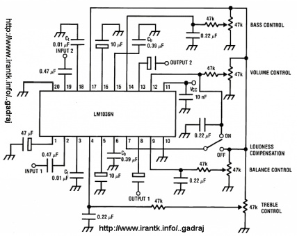

با سلام :
اين هم مدار پيشرفته اي كه داراي كنترل هاي باس تريبل و ولوم استريو ديجيتالي با قابليت نمايش در سون سگمنت :
فايل زيپ با كيفيت بالا :
با تشكر .

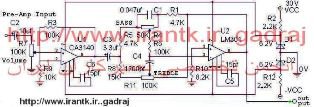

ميكروفون امپلي فاير
با سلام :
اگر از امپلي فايري استفاده ميكنيد كه از ولتاژ متقارن استفاده ميكند اين مدار براي تقويت ميكروفون ان بسيار مناسب خواهد بود مقاومتهاي تغذيه براي 30 ولت در نظر گرفته شده است شما ميتوانيد براي هر ولتاژ متقارن ديگري انها را ترميم دهيد تا 6 ولت متقارن را داشته باشيد .
در اين مدار از اي سي هاي كم نويز با بازده بالا استفاده شده كه كارايي انرا جلب توجه كرده است .
با تشكر .
موفق باشيد .

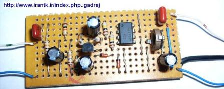

پري امپلي با كنترل بهرهpreampwhit agc
سلام :
يك مشكل اساسي كه در امپلي فاير هاي با تقويت پري به وجود مياد اينكه با زياد كردن ولوم كنترل براي داشتن صداي قويتر سوت كشيدن گوش ازار بلندگوهاست {عمل فيدبك m/l يا راشينگ } البته در استفاده از ورودي غير ميكروفوني نيز صدا توام با نويز و نامفهومي {تودماغي و... } ميشود .
در بعضي از مدارات پيلترهايي براي حذف سيگنالهاي زير{بالا} تعبيه ميشه تا از اين عمل جلوگيري شود كه خود اين صافيها موجب افت كيفيت پري مي شود .
مدار زير يك پري امپلي فاير ساده ولي اورجينال ميباشد كه داراي مداري براي كنترل توان تقويت شده ميباشد {{ agc يا همون كنترل اتوماتيك بهره } با بهره گيري از سيستم فيدبك منفي اتوماتيك }}
مدار در برد سوراخ دار تست شد و بازده خوبي دارد تهيه pcb به عهده خودتون .
دانلود و مونتاژ كنيد .
موفق باشيد .

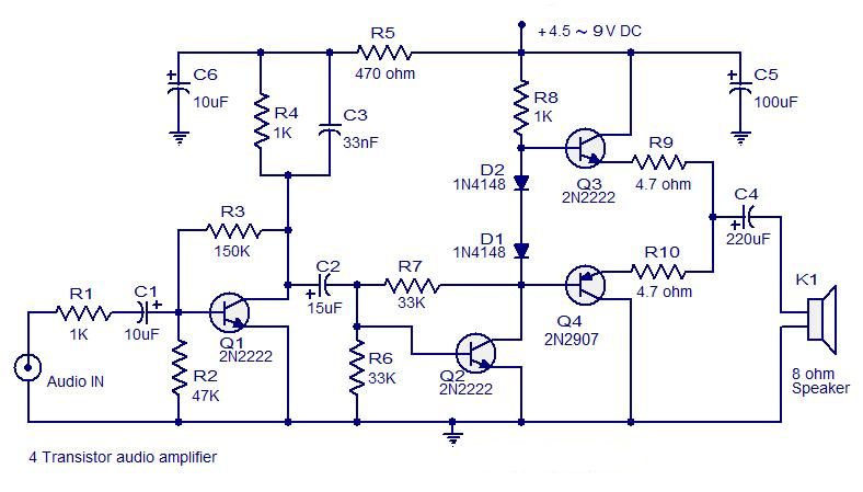

با سلام :
این هم یک امپلی فایر خیلی ساده ولی با بازده بالاتر و کاربرد عمومی تر بنا به درخواست 6466 فقط با 4 ترانزیستور خیلی معمولی :
دانلود کنید : [hide] [/hide]
[hide][/hide]
[hide]amplifier.png[/hide]
موفق باشید .
